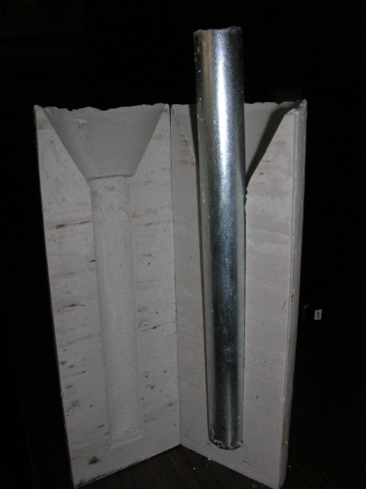

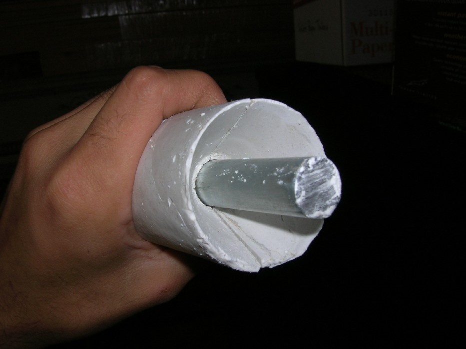

Well I've been tinkering around with ideas for my combustion cannon, and so far I have this... Its just a plaster of paris sabot and steel rod... The plaster is still a tad bit heavier than I'd like to see, so I'm going to try a Pykrete type mixture with the plaster by adding either styrofoam or sawdust. The steel rod will of course be sharpened to a point on my final product when I go to test it... :wink:
Open Sabot and Rod
Open Sabot and Rod
Sabot and Rod
Sabot and Rod

Plaster eh? I gotta try that? Do you mold it like ice?
The Doktor
Posts: 14
Joined: Thu Jul 12, 2007 1:37 pm
yea, I did it the same as ice. I figured, ya it would be a tad more expensive, but it sets in a fraction of the time and its not nearly as heavy by itself, then you can add foam to make it lighter...
