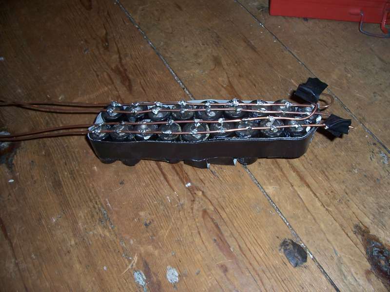

I just remembered something I had upstairs.
A capacitor bank with 18 200v PSU capacitors of various farad ratings.
I originally wanted to make a small railgun, but I couldn't find a suitible rail material or a dc pulse switch.
What results could I expect if I made a coilgun with this? I want to know if it's worth it before I buy a bunch of magnet wire.
