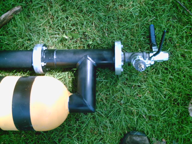

here for your viewing enjoyment is my new high pressure golf ball
accelerator named "the stinger". chamber is a firefighters air tank rated to 2216 psi. barrelis 72 inch long piece of aluminum pipe with 1/2 inch thick walls.
t-valve is 2.5 inch pipe with .250 wall thickness. all flanges are made of
.5 inch thick plate. porting is exactly 2.000 inch. piston is made from a
solid piece of billet alum. 6061t6. machined to the hourglass shape.
3/16 inch thick rubber sheet bolted on the piston with a compression washer for the barrel sealing end. 3/8 thick rubber cemented on the back
of the piston for the bumper. pilot dumped with 3/4 ball valve.
i have tested up to 150 psi with great results. golf balls are hard to see
go. i have a 300 psi compressor on the way. it should easily handle that. all the
welds were tig welded by an expert aluminum welder. all welds were
a minimum 3/8 thick beads. all flanges are o-ring sealed and bolted with
5/16 bolts. piston is servicable and barrel is removable.
will hopefully post video next week of the stinger after i get the 300psi
pump and i make some multiple sheet plywood targets.
it really is alot of fun now at 150.
next project is an aluminum welding tank with 4 time cubic inches volume
of the stingers chamber. plan to shoot softballs with it.
*******update*******
shot some video of the stinger today. still working on the 300+ psi setup.
heres the links below. was shooting between 100 and 145 psi. distance to target was about 15 feet. golf balls went easily through 4 sheets of 1/2 inch plywood. could hear them richocheting off tree behind the target. last shot hit the ply where there was a 1 inch thick backing board. went clean through that which is a 1 and 1/2 penetrating round. my six year old grandson shot the vids. he did pretty well for six. hope you enjoy as much as he did.

now imagine the power at lets say 300 psi?
scatdawg
Posts: 87
Joined: Thu Mar 29, 2007 5:06 pm
hopefully my compressor will arrive in the next few days so i wont have to just imagine 300 psi anymore. it will become a reality.

scatdawg
Posts: 87
thanks for all the compliments. im going to go shoot it some now.
will try to post some damage pics later tonight. but it wil only be at 100
psi. thats all the higher my buddys compressor goes where i will be shooting it.
