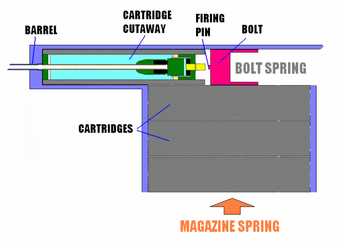

The main reason I abandoned this design was the lack of power blowing back the cartridge, mostly because the massive (in comparison to the 6mm valve port) 0.75" barrel that didn't allow sufficient pressure buildup. I was aware of this point but SPG brought it up recently and got me thinking again.
I did a small experiment and blocked off the breech with a 6mm aperture to see if it would make a difference. To say that it worked is a bit of an understatement, even without a projectile the thing blew back with such violence into my hand that it turned the tip of my finger purple :?
As such, I decided the project merits revisiting, but rebarreled in 6mm calibre. If the burst disk cartridge fails to materialise, I will certainly give it a go. I would prefer the former - simpler (though probably more expensive due to the threaded section) to manufacture, no dead space and a faster valve would mean more power - but the mini-piston isn't too hard to make either, I would happily churn out ten or so.
One concern with the piston design is that the firing pin would prematurely fire the cartridge if it encounters too much friction while pushing the cartridge, so perhaps I should have it free floating and open the valve by inertia once the face of the cartridge has stopped against the breech.

maybe you could put a weak spring in front of the bolt to push the cart forward but when fireing the spring easily compresses and the pin cac hit the shrader. But where will the cart eject?
spudchucker wrote:But where will the cart eject?
That's easy, all you need is an open port to one side and a ridge of some sort on the other, when the base of the cartridge hits the ridge it will tip out of the port. I used this idea successfull in my cartridge-fed pneumatic.

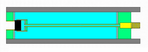

I think you should try to modify the schraders like for a rubber schrader, remove the valve and use a nail or something that seals against the rubber stub and then just make some spring return system, it should have higher flow or try something because schraders really suck
iknowmy3tables wrote:I think it would be pretty awesome if you used some of the extra length in the new design to shoot mini spears like projectiles
Schraders suck for larger launchers, but when you're down to this scale they're perfectly adequate as pilots. Also, increasing its flow would increase the force needed to strike it open, which is not a desirable trait in this case.
I prefer to use "conventional" short projectiles like pellets and cut down on the pilot volume, here's a design I've been pondering with a solid rubber piston. The pilot volume is increased (no, I'm not high or anything :P) but this should be offset by the fact that dead space is almost zero compared to the original design.

Wait is dead space bad or am I high?!
Dead space is that volume which the air can expand into after exiting the valve before it hits the projectile - for example if you only load your projectile half-way down the barrel, then the first half of the barrel counts as dead space. As it expands, it loses pressure, so ideally it should be as close to zero as possible.

Is it posible for you to use a diaphram as a valve in the cart?
Now after looking at the diagram you made I would like to know where the air gets into the cart chamber is there a equilization hole?
