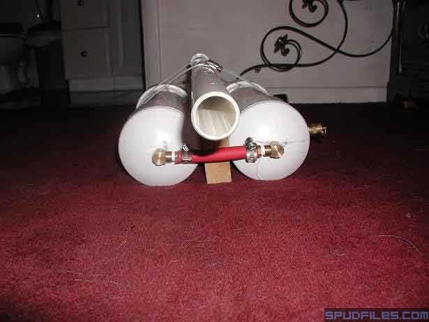

Its called the hell raiser and it is a double chamber gun.
THE RESULTS WERE AMAZING. IT WENT SO FAR I LOST TRACK OF IT. FOR SURE IT IS THE MOST POWERFUL GUN I'VE BUILT. DAMN IT RULES. I ONLY GOT TO CHARGE IT TO 40PSI THOUGH. BECAUSE OF WHERE I LIVE.

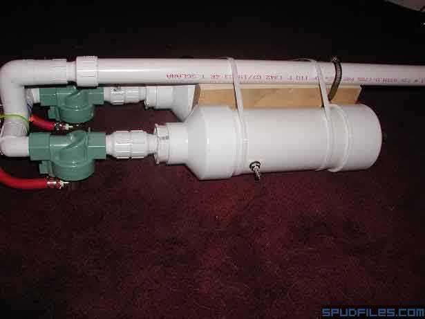

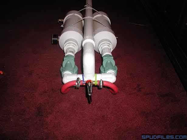

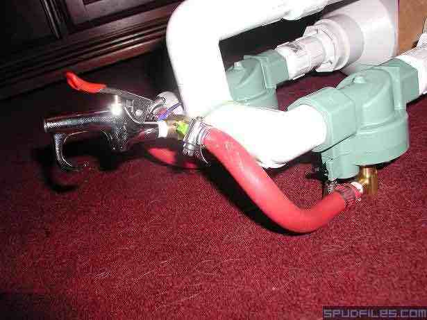

I have a two 1" Watermaster valves hooked to 1 blowgun. (hoping to use a ball valve instead of a blowgun)
All bronze fittings are 1/4" fittings
My barrel is 1 1/4" (I meant to use 1.5" though)
4" Double Chamber
Provided By - EvilEyeMonkey</div>

Awesome. Just one question. If you are using 2 1 inch valves then you have a total airflow of 2 inches. As far as I can tell everything on the barrel side of the valves is only 1 inch though. Arent you constricting your possible airflow?

oh mama! this sure is a nice lookin launcher. quick question. what kind of sprinkler valves did u use on this gun?
spudshot
Posts: 1036
they're Orbit Watermaster 1" valves

Hey thanks man. And this is for the builder. Have you seen the AutoSpud, you should definatly hook your gun up with a stand similar to his. thats just what this gun needs. Oh and i forgot to comment about your set-up of the two valves hooked up to the blowgun. Very nice, very clean
