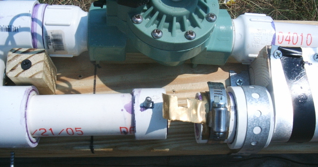

And now the prototype G.A.R., here’s a large view of the prototype with labels to explain it.

It looks good on paper but I have my doubts as to how much bleeding from the barrel will work at spudgun pressures. Firearms that use this system typically generate at least 30,000 psi, nowhere near spudgun pressures.
For this to work well you're going to need a large chamber volume, high flow valve and a sufficiently long barrel to retain the pressure long enough to allow the piston to work. Remember, you've increased the area availiable for the air to work on but you've also added to the weight of the bolt.

After looking over my plans (which are mostly still in my head) I realized that the gas cylinder on the GAR 1 was made wrong, if you look at the pictures of the charge handle/barrel guide area that grove is in the cylinder, between that grove, and the utter lack of seals, the gas cylinder might as well not be there and just have a ported barrel. This is what happens when you rush perfection…
Do I try and make the GAR1 work or do I just go strait to the finished product, a 1.50cal auto-cannon?
With the 1.50cal I could use a solid lead slug if need be to get the recoil part to work, plus with NERF footballs, which fit really tight, they will create a good gas seal which gives the gas system a better chance of working, plus when I shoot NERFs out of my Bazooka I can feel the recoil.
But all have to buy a lot of stuff, and if it doesn’t work it’s all that money down the drain.
If I just fix the GAR 1 it’ll save money, but for all the work, am I just polishing a turd?
