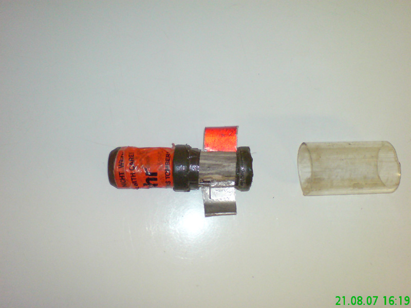

just put together a thing i had in my mind for a week. Ammo with unfolding wings like a rocket. I guess this will make it rotate and remain straight in flight
In front of and behind the wings there is a ring, which fits exactly into the barrel and seals it. between the rings, the wings with tensed springs are held smaller than the barrel diameter by a ring of paper. When the projectile leaves the barrel the wings pop out- the springs make them and the paper is just thrown away.
There is a brass cap on the tip to make it heavier an i added orange tape for better visibility.
It took nearly an hour to build(bad tools) but it's very simple. just look at the photos an you will know how it works.
Just made one test shot. Wasn't impressive (its raining and my good bike pump is broken). fired at ~~100psi hit a piece of wood. Looks like it remained straight. It's just a prototype. The unfolding works good. its just "click" and there tey are. I took the springs from my old printer.
I'll post when more testing is done. Maybe i can post a video.

Looks a bit crude but it seems like it will work well enough, almost a shame to fire it.
Note that finned projectiles don't need to be spun to be stable in flight, in fact spinning them will cause extra drag and reduce performance.

That's a really good prototype, quite ingenius on your part. I can say that I've seen things like this before, but I don't recall ever seeing one made for a spudgun. In order for those wings to cause spin, however, they will need to be tilted a bit, like fan blades.

Uber cool! would adding more fins help, maybe one more?

In theory, yes, but a finned projectile will only go straight if it is built very precisely. Otherwise it will always have a tendancy to turn one way or another, so a slow rotation would actually improve accuracy.jackssmirkingrevenge wrote:Note that finned projectiles don't need to be spun to be stable in flight, in fact spinning them will cause extra drag and reduce performance.
And that ammo looks very cool, could you get a vid of it being fired?
