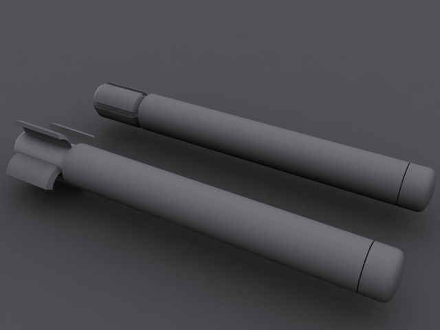

Projectile Prototype with unfolding wings

Very nice! I've had an idea similar to yours for about a week now. I'm planning on trying to make this and if anyone else has the materials on hand feel free to try your hand at it.
It's basically a FFR (Folding Fin Rocket) like yours only made of sleeved PVC pipe. If anyone knows what types of pipe could be sleeved together to give an OD the same as the ID of 2" SCH40 I would really like to know so I can get started on this. You wouldn't want to fire it at a sheet of plywood but I think it would be good for distance shots with the right nose cone.

Well to make it easy you could just get a piece of pipe and cut a small section out of it lengthwise and just squeeze it inside the other pipe.

for the spring mechanism you could use very thin gauge sheet metal or spring steel from an old wood saw ive made a powerful crossbow using that stuff
I like the spring steel for the springs idea, it would make it more damage resistant and it would be alot simpler then a complex spring setup. You could also cut up the spring band in an old lawn mower pull starter and make several rockets.
I just made 3 more test shots (pneumatic) and it works quite well. Made a video but you can't see anything at all, crappy camera.
This prototype is not very damage resistant. I shot it with a pressure of 120psi. It hit the target with the brass cap first but the fins got bent an i had to fix it. I think that is to much work for a thing that is meant to be shot at hard targets with the violent force of a hybrid launcher. If i try a hybrid shot at a 2x mix it will probably be useless. Unless i find a better way to build such a projectile it is not worth the time.

What it would be useful for is distance shots. You could devise a remote firing mechanism to release a parachute.

In reality you can achieve the same stabilising effects as fins by having a hollow base or lightweight tail, it must be admitted that the key appeal of fold-out fins is that they're really coolRock wrote:Unless i don't find a better way to build such a projectile it is not worth the time.
Those spring loaded hinges would do the trick I think. You could bend them to shape and use a dremel to carve out the pvc pipe and fins so they sit flush with the pipe when the fins are closed. There is a big selection of pipe were I work and the boss told me today to take what I like so this maybe a job for this weekend.
