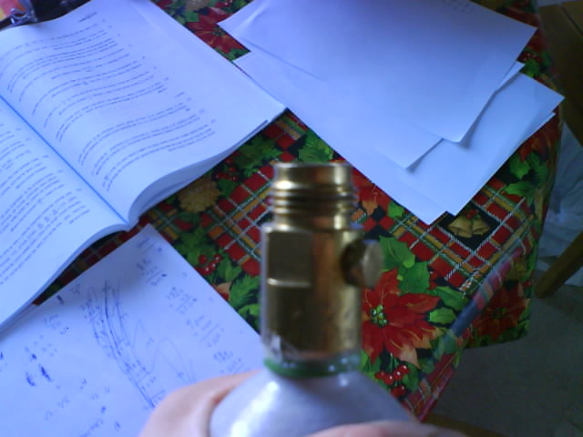

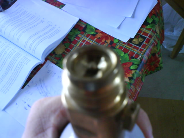

i buy the soda-club tank that include 260g CO2.
do you know what i can do with the open of the tank? how can i connect it to iron chamber? i don't know how the soda-clab tank looks in other countrys, here is a few pic's, not so good quality

What kind of threads are those? If you know that, you can probably find a regulator for it.

BTW, those are just standard CGA 320 threads.

That looks like a little paintball tank, get one of these:
http://cgi.ebay.com/Purple-Tank-Adaptor ... dZViewItem
It has 2 outlet ports and comes with a plug for one. Put some Teflon tape on the plug and screw it in one of the outlet ports and use the other for your expansion chamber. The outlet threads on the adapter are standard 1/8" pipe threads. For better efficacy without wasting Co2, put a metal ball valve before the expansion chamber to fill it and close off the tank supply when full. And another metal ball valve to fire.

i want to pressurize my chamber with the tank, i gess that i'll buy what Orpackrat says.. but i'll need to order that from eBay, i don't think that someone sell it here..
