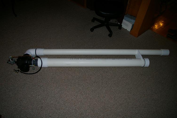

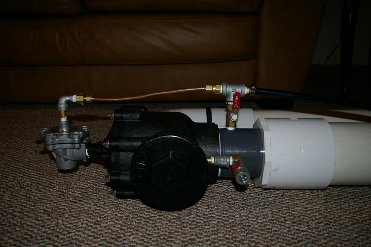

3'' 100-p Irritrole Sprinkler valve.
72'' 3'' barrel
64'' 4'' chamber
Piloted by a 3/4 inch QEV, threaded to valve stem.
Enjoy.
Update - Home from mid-semester break... Here are some photos.
Maybe ill do the concrete bean can before i leave.
BFG 9000

Wow, that is indeed quite large. What pressure do you take it up to?

Thats one MOTHER of a cannon,Love it!How did that 3" irrigation valve cost?Looks like it your of been a pretty penny.
I'm guessing BFG-9000 is Big Fuking Gun 9000 Cubic Inch?
Could you get some detailed pictures of the cannon loaded up,I'd love to have a look at it.

More importantly how much did it cost?

That is one big arse sprinkler valve
good job
good job
That's one nice gun, I like your backyard it seems ideal.
What kind of range can you get out of that thing?
I hope you haver many more prosperous shootings.
Oh yeah, and that is one BadArse sprinkler valve.
Happy SPuddin'
Happy SPuddin'

bleedin' heck! turns out size *does* matter
I presume you were using fairly light projectiles if you could handle the recoil?

Wow. This on your first post? Very nice cannon. I...love you.

thats a hue cannon.

hey, thanks for all the feedback.
the bfg 9000 is just a gun in doom and i thought it was a fitting name.
the valve wasnt that bad... only 60 on ebay.
and ive been shooting steel bean cans out of it wrapped in duct tape. i just left for college, so all my pictures (and gun) are at home so a video will have to suffice for now. other than that, its awesome to shoot and the power is amazing.
