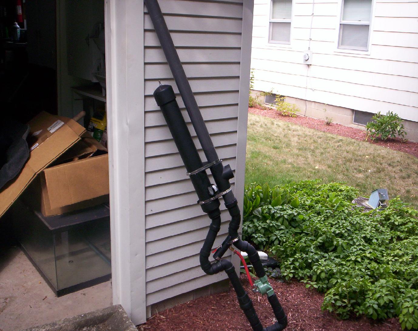

I made a cannon (my golf ball launcher) seen below and it wasn't enough power for me because there was alot of dead space in the launcher which I didn't like. I decided to modify it for power, minus the looks. I shouldn't have done this. The cannon now is more powerful, but it just doesn't look quite as cool as it did

1. move your blowgun to the lower 45 coming off your chamber, removed the upper p-trap and gotten a longer barrel. the larger pilot volume would be a small sacrifice.
2. move your sprinkler valve forward to behind your breech eliminating most dead airspace. you could then possibly get rid of the hose to your blowgun making your pilot volume minimal.

What you should have done with this, is have the simple over-under of the new gun, but have the stock of the old. The stock isnt connected to the air, therefore minimalizing kinks and increasing power, whilst still looking great.
