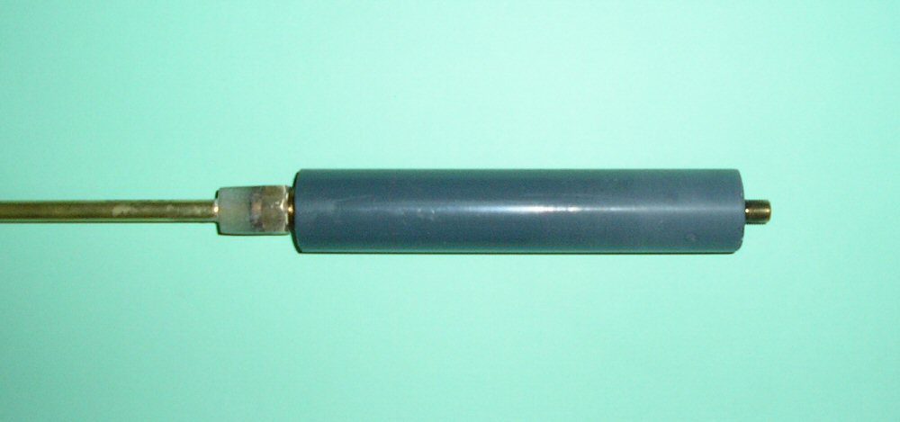

Nice gun jack. I pondered the same thing earlier today. Think you could break the sound barrier?

Nice velocities,only 12 FPS off the sound barrier(Sea Level)if I remember correct.There is no reason why you couldn't break the sound barrier,but could you be getting incorrect results from having the chrono to close the the muzzle?I did that with one of my pneumatics and I thought I broke the sound barrier but I was really about 200 FPS shy.
The reason that he couldn't break the sound barrier is because he is using room temperature air. Unheated air will not push a projectile past the speed of sound under normal circumstances.

Not necessarily. As it's being pumped in, the temperature will have risen quite a bit.DYI wrote:The reason that he couldn't break the sound barrier is because he is using room temperature air. Unheated air will not push a projectile past the speed of sound under normal circumstances.
It's also not impossible to achieve supersonic air currents in a smooth enough barrel. If the pressure differential at the valve is high enough, and the projectile is really light, the supersonic air currents generated at the valve could continue down the barrel. And if your airflow is supersonic, you can get a projectile to go supersonic.
Take something like this MTU.
That uses supersonic airflows to generate vacuums. (Actually, that 6.3mm version might be useful to enhance a BBMG...)
With that C:B ratio, the smoothbore brass barrel, a burst disk and 400 psi of air at above room temp, it's far from impossible.

I certainly wouldn't want to be hit by one, here's some 0.25 gram BB tests:What kind of damage can it do with a .12 gram?
0.25g BB at 1017 fps straight through a steel (empty!) lighter fluid can
0.12g BB at the same can, only penetrated one side. Sadly the chrony didn't get a reading.
0.25g BB at 982 fps straight through a plastic toy container
Actually not that loud, thanks to the approximately 1:1 chamber/barrel ratio and long barrel.very nice. how loud is it?
That's the way this particular chrony is meant to be used, and as I've said I've compared it to other chronies at high velocities and got consistent results.could you be getting incorrect results from having the chrono to close the the muzzle
Not so, commercially available air rifles like the Airforce Condor can break the sound barrier using unheated air and a hammer valve.The reason that he couldn't break the sound barrier is because he is using room temperature air. Unheated air will not push a projectile past the speed of sound under normal circumstances.
I don't think it is impossible to push a projectile pass the speed of sound with air pressure, it is just difficult. I will be trying it soon, and hopefully I can make it happen.

No sound unfortunately, 3 digital cameras in this house and none of them have a microphone
I tried a Diabolo Baracuda extra heavy 31 grain 0.25 pellet (6.35 mm, needs to be rolled down a little to fit the barrel) and got 577 feet per second, an impressive 23 foot pounds
Sadly I still can't get a velocity reading for the 0.12 gram BB, the chrony keeps saying "bad"

Impressive energy figures for something so small. Considering how that stacks up at about 20% of the .22 LR round, I'm damn impressed.
Yeah, I know the .22 LR is pretty wimpy, but I still wouldn't want to get hit with it.
Any idea why the chrony is objecting to the .12g?

Has anyone ever tried drawing a vaccuum in the barrel to increase the initial pressure difference? A thin burst disk on the end would be used to seal it before the projectile hits.It's also not impossible to achieve supersonic air currents in a smooth enough barrel. If the pressure differential at the valve is high enough, and the projectile is really light, the supersonic air currents generated at the valve could continue down the barrel. And if your airflow is supersonic, you can get a projectile to go supersonic.
A better question is, how much difference would it make?

You would of nailed mach 2 in Hybrid form (jokes).
Well done with those velocities, the lighter bb that the chrony can't read must be going super-sonic
Let us know when you get bored and turn it into a hybrid 8)
Nice work.

how are you using tape as a burst disk? can you demonstrate in any way?
