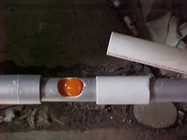

***Poorman's Breech***
The Poorman's Breech is nothing more than a piece of pvc the SAME SIZE of the barrel cut to about 1 or 2" long and then taking a sanding bit for a dremel and grinding the inside of the pvc piece till it slides over the barrel (not too tight or loose tho) once your "breech" is able to slide over your barrel you take a dremel and drill 5 holes in your spudguns barrel about 1/4" infront of your valve on your barrel. (3 in straight line 1 on either side of middle 1) now connect the 5 holes with your sanding bit and round it to a circle big enough to fit your ammo in.
slide breech forward, load ammo, slide back back over loading hole
& FIRE! (loss of some air but could be made air tight easily)
poormans breech.JPG (58.51 KiB) Viewed 13962 times
