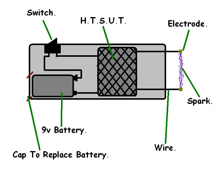

I was talking to my dad who has a degree in elctronics and is a flight simulator engineer. And asked him how to make a continuos spark for a stungun ignition. He said that it was really easy to do and were going to test it in a few days when I make some money. The parts are available at electronics store and just ask the store clerk guy for them. Thats what Im gonna do as I have no idea what the HSTSUP is. The parts he mentioned are an SPST Switch, a High Turns Step Up Transformer and a 9 Volt Battery. It shouldnt cost much. I made a diagram and asked my dad about the setup. He said its a good design so lets just hope. Be really carefull though. I take no responsibility if you kill yourself or anything else.
Design.
Design.

how many volts will it put out, and what the hell is the hstsup that u mentioned in the description? i like the design, hope it works out for you
how are you gonna fill a chamber when the spark is continous?
i didn't miss anything? did i ??
o, i get it, dhaaaaaaaaaaaaaa, it's got a switch to turn on and off, dhaaaaaaaaaaaaa !!
i think it will burn the entire load of fuel set up that way, but will it work better ?

Atlantis
Posts: 955
I think he's talking about a High Voltage Step Up Transformer. It lowers the current but increases the all important voltage. My disposable camera ignition has one on the circuit board inside.

Yeah also I was looking at rambos mini combustion auto and this would bo perfect. I dont actually know the power output of the spark when Ive built it I will test it and post. The HTSUT is a 'high turns setup transformer' you can get them at dick smith or radio shack or something. My dads bringing one home from work so Ill post a picture so you know what to look for.

Atlantis
Posts: 955
I was close to the name, and does it really matter how many volts you have? I'd measure how long I can make the spark.

FiveseveN
Posts: 337
Joined: Fri Oct 14, 2005 5:48 am
Location: Nowhere
Not to be rude or anything, but... do you people even know how a transformer works?! Does AC ring a bell? It can't produce multiple sparks with DC, ergo static magnetic field. It will, at best, spark once. You'd be much better off using an ignition coil.

FiveseveN
Posts: 337
Location: Nowhere
Basically, a transformer changes electricity from high to low voltage using two properties of electricity. In an electric circuit, there is magnetism around it. Second, whenever a magnetic field changes (by moving or by changing strength) a voltage is made.
From http://www.energyquest.ca.gov/how_it_wo ... ormer.html
A static magnetic field is a field that doesn't move or change over time, thus producing NO VOLTAGE. The magnetic field created by DC doesn't change, because DC doesn't change. The ignition coil is not your usual step-up transformer. I's magnetic field cascades when the ignition circuit is open, creating high voltage in the secondary. Google it for more info.

really what u are describhing is a stun gun i believe, im not sure but a stun gun might also have a capacitor on it. however i think that, at least normaly, stun guns ussualy do have a continous spark. this is because for a stun gun to be useful you really dont need tostun a man sometimes... occasionly the crackle and buzz that occurs will deter them
rna_duelers
Posts: 1739
Location: G-land Australia
K40T1C,Dont stun guns pulse to course muscle spasms and thus diabaling the person,if it where continous all the muscles would contract and stay contracted until the current is released,and if say that person was wealding a firearm of some sort it would most probalbly be shot due to the muslce contarction.thats why on electic fences they pulse,because if some 1 garbs onto it they might not be able to let go of the fence if it where a continous current.
