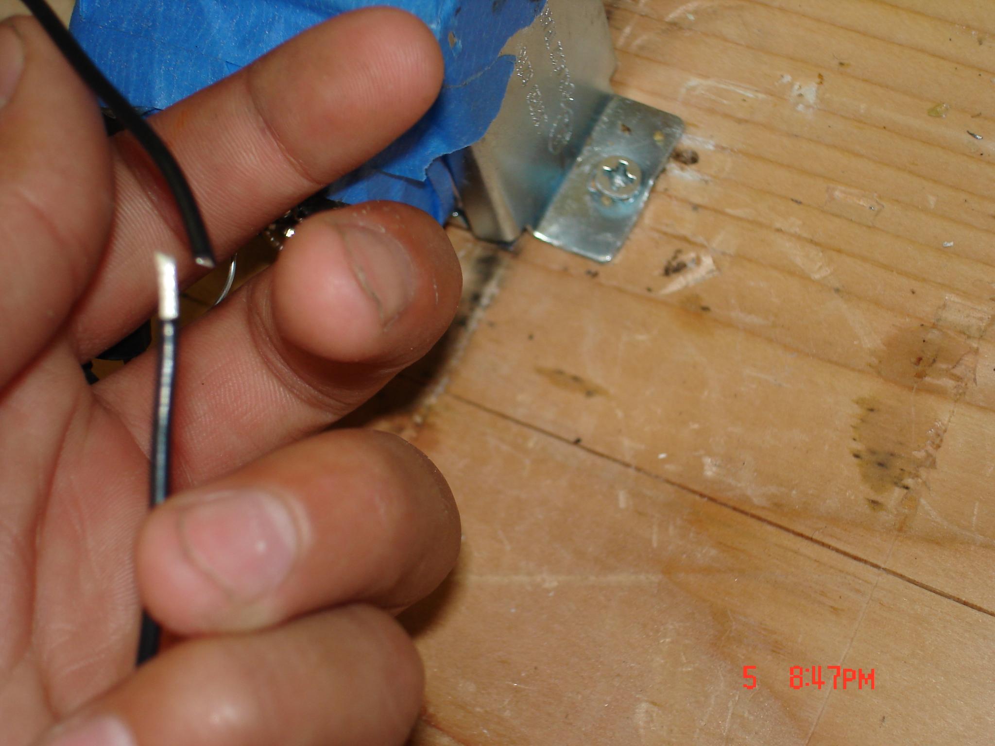

this is where i severed the wires to the recifer
