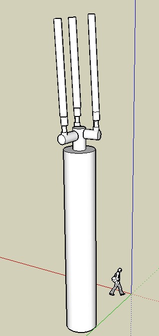

I agree with wiliamfeldmann, You should use juts one barrel with the nets and balls in it.
Did you notice how the net Jamie fire in the Episode went?
It wasn't all that far probably 50ft at max. Putting it all in the one barrel would work alot better.
Though if you gave each barrel it's own individual valve it might work better as well.Though you would still have to tackle the problem of synchronising them all at once, otherwise you'd run the risk of one valve opening before the others and releasing half of the air too soon.

Edit- I know It's Unnecessary, but I just got Google Sketchup and I was bored so I decided to do this off memory......
I know it's really unnecessary but I just got Google Sketchup so I thought I'd just post a Picture. The chamber is way out of scale, I know. <br /><br />It's one Godzilla of a cannon, look how many times it is taller than that guy.
Jamie's Bird Cannon..jpg (27.21 KiB) Viewed 8686 times
