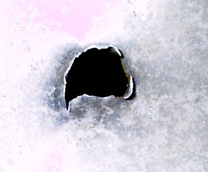

The barrel and chamber are both 1m long, the barrel is 25mm diameter and the chamber is 40mm diameter. The valve is a modified sprinkler valve. Unfortunately the particular devise that i purchased has a guide rod so I had to drill off to the side which caused quite a problem when it came to sealing the cannon. Because the barrel is slightly too big for a paintball it also allows for some more inventive ammo choices. Hows the penetration of rocks (no wadding) through this 3mm aluminium?

The rock lodged in the metal
