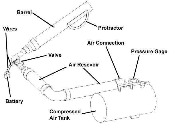

I have built a pneumatic potato/tennis ball lancher (with compressed air). I need to develop theory (i.e. equations and formula) to determine the velocity as the ball leaves the barrel. I have the projectile motion after the ball leaves the barrel down pretty well. I'm having issues accounting for pressure drop among other things.
As seen in the attached picture, there is a PVC resevoir with has compressed air. The valve opens by a current from the battery and the air shoots the ball out. Note I need physics forumlas and not a link to a projectile motion calculator site.

i know that this post isnt of much help, but i think that most people here (such as myself) just build and shoot cannons for the fun of it. some people do take it into a science and deturmine ratios and formulas and things like that, but for the most part people just do it for fun.
im not trying to put you down or make you feel like an idiot, but basicly the more pressure you put in it, the farther the tennis ball goes.
also, whats the upside down protractor for? you would need a board or something to put it against for it to do anything at all.

just add a weighted string and you have an el cheapo elevation gauge.also, whats the upside down protractor for? you would need a board or something to put it against for it to do anything at all.

Modelling the internal ballistics of a gun, particularly a compressed air gun is non-trivial. GGDT contains some pretty heavy duty mathematics and physics.
I think your best bet is to make a number of assumptions so things are more tractable.
Ignore the pressure drop across the valve and through the plumbing. Assume the valve opens instantenously. Ignore the static friction between the ammo and barrel and assume there is zero dead volume between the valve and projectile.
Set the calculation up as small times steps, say 1 millisecond (or less).
The pressure at time zero is simply the resevoir pressure. The force on the projectile is the pressure*area. The acceleration is a=F/m. The velocity at the end of the time step is the velocity at the previous step plus (time step size)(acceleration). The position at the end of the time step is the previous position plus the (time step size)(velocity)
Since the projectile has moved the chamber volume has expanded. So, volume at time i is the volume at time zero + (distance projectile moved) X (area of barrel). If you ignore temperature affects then the pressure in the system just drops by the ratio of the initial and the current volumes. (I believe GGDT treats the affects of the drop in temperature.) You can take into account the temperature affects, post back if you get to that point.
The calculation just repeats until the projectile has moved the length of the barrel.
As a refinement, you can include the affect of friction between the projectile and the barrel. The force equation just changes from F=ma to F=ma+(frictional force), rearranging gives the acceleration; a=(F-frictional force)/m.
