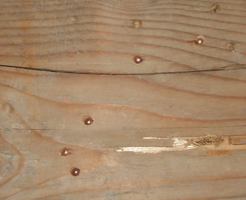

Windshrike's comment here reminded me of a little project I had made a while ago to see the effects of high pressure in a BBMG. Since my only pressure source was a shock pump, I had relatively small chamber (that still takes me about 2 minutes of hard pumping to take to 400 psi) and used a piston valve built in the same way as my mini designs with an epoxy piston in a syringe tube.
It looks ghetto, I know, especially around the breech area, because it's been cut up and rebuilt many times - currently fitted with a 4.5mm I/D barrel for steel BBs, 15.5 inches long - but originally it had a 6mm airsoft barrel. With the current barrel it shoots an average of about 650 feet per second with BBs but is only good for a 5 round burst. as you can see from the damage pic, that's enough to embed BBs to a little more than their own width into a wooden plank.
edit: 5 round burst vs soup tin at 420 frames per second, the distinct impacts can be more readily discerned:
dug it up and made a couple of videos:
5 round burst through soup tin bottom
5 round burst through soup tin side
3 round burst through soup tin side
A "normal" BBMG (ie using typical compressor pressures of 100-120 psi) will succeed in chewing through a similar target, but in this case the effect is achieved using much less ammunition. A single BB at 650 feet per second is enough to fully penetrate 2 soup tins side by side and emerge with enough energy to dent a third can. Single shots from a vortex block BBMG at 110 psi will only dent the first tin. Note also in the second and third videos that you can distinctly recognise the individual exit holes of each individual BB as opposed to the "tear" from the action of many BBs at lower velocity.
