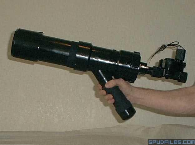

Here's my latest cannon I built over the weekend, The Punisher. It's a coax design with the most simple diaphragm design I could find. The gun is about 17" without the sprinkler exhaust valve. I haven't put any goodies on it yet because I haven't decided weather to mod the sprinkler valve with a blowgun or just go with a small electric push button trigger. Here's some photos:</div>
Here's a picture just to let you get a good idea of the size of the weapon. I wanted it small and hand held so this is what I came up with. I use those foam practice golf balls as primary ammo.

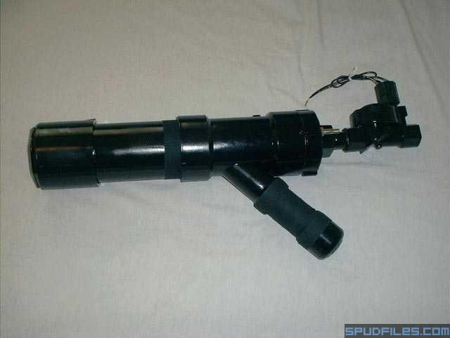

Another shot of the assembled gun. I used a 3&amp;quot; Wye fitting and just built around it until I got what I was looking for. About 5 stomps on my foot pump gets it up to 20psi, gotta love that about small chambers.
Another shot of the assembled gun. I used a 3&quot; Wye fitting and just built around it until I got what I was looking for. About 5 stomps on my foot pump gets it up to 20psi, gotta love that about small chambers.

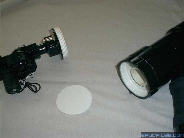

The Punisher broken down. Did I mention it's simple? Just a clean out plug and diaphragm! The clean out plug has a 3/4&amp;quot; steel nipple (hehe) threaded into it along with a regular Schrader valve. That's not the configuration I hoped for, but space is at a premium at the back of the gun, and it still works.
The Punisher broken down. Did I mention it's simple? Just a clean out plug and diaphragm! The clean out plug has a 3/4&quot; steel nipple (hehe) threaded into it along with a regular Schrader valve. That's not the configuration I hoped for, but space is at a premium at the back of the gun, and it still works.
This poorly taken photo was supposed to be a shameless plug for the Rubbermaid company! I cut the diaphragm from a Tupperware lid. I didn't need to drill the hole at the top but I wanted to make sure air would pass through and it does. <br />    <br />Yesterday I cut a 1/8&amp;quot; neoprene rubber disc and used it in place of the Rubbermaid disc. The noise level was reduced a little and the neoprene has more flex so I get more power per shot.
Yesterday I cut a 1/8&quot; neoprene rubber disc and used it in place of the Rubbermaid disc. The noise level was reduced a little and the neoprene has more flex so I get more power per shot.

how stiff do the disk things have to be

is that white disk the piston? Sorry about the noob question im new to piston valves.
