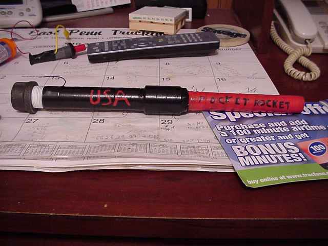

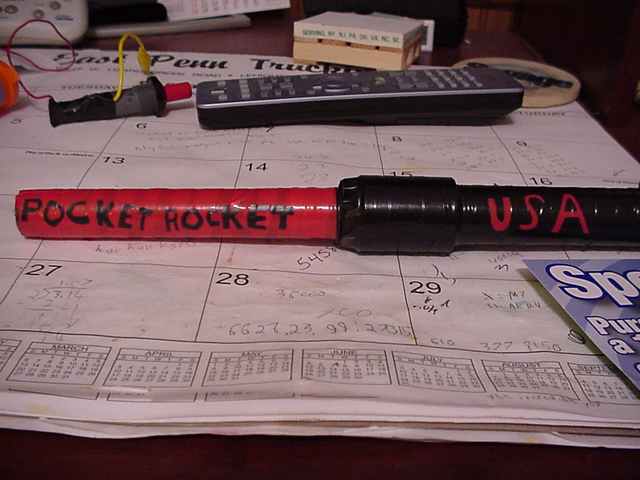

I finished my new combustion launcher, all out of black iron piping, its called the pocket rocket, and measures only 13 1/2" long. a spritz of cologne sends wire nuts flying. the parts from cap to barrel are 3/4" endcap, 3/4" 6" nipple, 3/4" coupling, 3/4"-1/2" reducing bushing, and a 1/2" 6" nipple.
it took me about 5 minutes to put it together, but about 45 minutes to cut out the letters from tape.

man, i just built a clone of this and it is great! what ammo do you use usually? i can't find anything that is a good fit in the barrel.
bye!
EDIT: also how much fuel should i use? i get it right every 4 tries but i want it perfect. i use butane.
bye!
spudshot
Posts: 1036
try some wire nuts or AA batteries, i use a small spritz bottle of cologne to power it, try putting a ligher in the open end and press the button but dont spin the flint, so just the butane comes out

How did you get it to arc in the chamber? A wire inside the pipe or something?
spudshot
Posts: 1036
yeah, then i epoxied around the wire, the other wire is just wrapped around the chamber's outside
