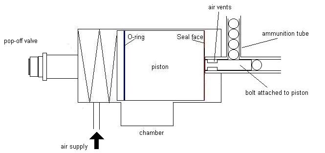

ShowNoMercy
Posts: 1094
Location: Jersey Bitches!
Why not try and extend your sealing face to also include something to load rounds?

Interesting, I had sketched something like the attachment once but never got round to building it as I wasn't sure the whole piston resetting thing would work. It might merit a prototype...

ShowNoMercy wrote:Why not try and extend your sealing face to also include something to load rounds?
Well i waqs going to start a drawing but jacks got it perfect, that would work, its like your semi auto gun jack (BB gun, the one you attached to the nailgun) the one in the syringe tube :D
I think that design could work, but you'd have to get the right size spring, and i dont think the o-ring would seal the exuast hole though.

Wouldn't the bolt on the piston jam the ammo?

If you are referring to Jack's diagram, as long as everything is measured and lined up, it should work good. I'm sure his diagram was similar to mine; a rough sketch.

Alrighty then... I bet this would work great in the gun that im making. 500psi CO2 "Assault Rifle" - steel/copper - semi/fullauto
I think it would be a better idea to combine the idea with mark's pop-off pilot concept, though perhaps it would be able idea to have a separate feeds to both chamber and pilot with a check valve from the chamber to the feed in order to ensure reliable operation.
The question is, will the piston go back far enough to reload the breech?
