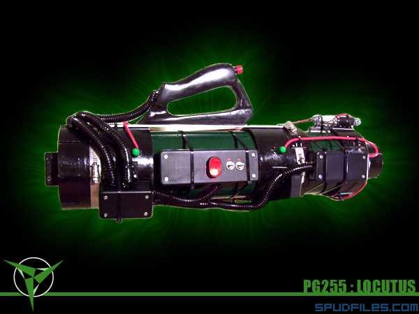

"Locutus" was built soon after "Thug '03". Talk about a project getting WAY out of hand...
"Locutus" is a monster. It took over a week to build after the plans were laid out (a long time for a spud launcher!). It was also the first time I have ever used an electronic high voltage ignition system - salvaged from a stun gun. (It was actually pretty simple) All in all, it was a fun launcher to build, and a fun one to launch :)
The Locutus is currently my crown jewel. It features the following accoutrements:
~255 cubic inch chamber
Dual fire 100,000 volt ignition system
3 step kill switch system
"VisaFire" system (allows safe viewing of ignition jump so you don't have to look in the chamber - my own personal design :) )
Brush less chamber fan with piggyback switch (allows easy use of the fan without having to put down the gun)
Minigun style grips (wood, aluminum and fiberglass) for easy transporting and firing
All ignition system components have been designed to be water resistant
Ignition system has a patch-in location for remote launching
Interchangeable barrels
New design for the barrel cutter (makes it a LOT easier to cut a spud) </LI>
Provided By - <a href="http://www.vochraye.com/spud/">http://w ... /</a></div>
The &amp;quot;Product Shot&amp;quot;
The &quot;Product Shot&quot;

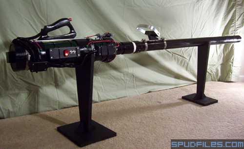

The PG255 &amp;quot;Locutus&amp;quot; with standard barrel attached. (those aren't legs - it is on a stand)
The PG255 &quot;Locutus&quot; with standard barrel attached. (those aren't legs - it is on a stand)

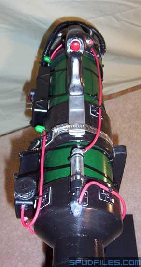

Detail of the chamber showing kill switches. The ignition switch is on the handle. The fan switch is on the opposite side of the handle, so you can't see it in this pic.
Top view of the chamber. You can see the fan switch on this one. The clear cylinder at the bottom of the picture is the &amp;quot;VisaFire&amp;quot; chamber that allows you to see if you have spark without looking into the chamber.
Top view of the chamber. You can see the fan switch on this one. The clear cylinder at the bottom of the picture is the &quot;VisaFire&quot; chamber that allows you to see if you have spark without looking into the chamber.
