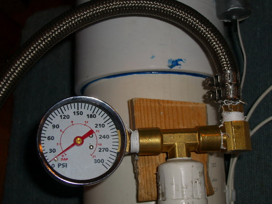

The propane meter is quite simple. Starting from the barrel I have a ¼ inch steel street elbow, a ¼ inch steel close nipple, a 1/4inch by1/2 inch steel coupling, a ½ inch sch 80 PVC close nipple, a ½ inch sch 40 PVC ball valve, a 4 inch long ½ inch sch 80 PVC nipple (this will vary based on volume of chamber), a ½ inch sch 40 PVC ball valve, a ½ inch sch 80 PVC close nipple, a ½ inch sch 40 cap with ¼ inch threads tapped into the top of it, a ¼ inch brass tee with a 1-300 PSI pressure gauge in one side and a ¼ inch brass street elbow in the other side, out of the elbow a ¼ inch by ¼ inch brass hose barb, connected to the barb is a length of braided hose used to hook up toilets, the other end if the hose is clamped to an old propane torch. All the sch 80 nipples are sprinkler risers and are available at any store that sells sprinkler supplies. The propane meter is tapped into the chamber at the end with the cleanout plug.
