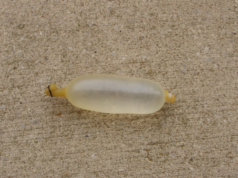

Unfortunatley I do not believe they were talking about anything that uses explosives, merely something more along the lines of a shotgun mixed with a tennis ball or latex tubing. Don't remember seeing anything about RDX or TNT or hell even gunpowder for that matter.spudgunnerwryyyyy wrote:explosive rounds are against the forum rules check it out as to not get banned
Anyway now that I'm done being a smart ass I think that if you were to use that Latex tubing idea it would work but might be a little too solidly built and might hurt if fired at a distance of 5 - 10 feet. what kind of cannon are you gonna fire it from, pnuematic i'm assuming so you can turn down your volume and pressure and what size barrel are you using

I don't think the latex grenade is going to work for the airsoft bbs. It probably will not break open on impact, which will cause the bbs to spray in one direction. They are not going to shoot very far either. The latex grenade is more suited for liquids.
never seen a latex tube before, looks kinda like a condom tied at the open end
pneumatic, 2-3" barrel probly 2, now that i think about it 3 seems really big
and that latex tube is gonna split on the side and spray in one direction like hubb said
