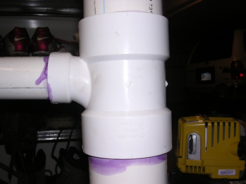

Could you get us some pictures of the fittings? Some fittings are called NSF-61, which while tecnicaly not pressure rated, typicaly correlates.

On the ends that you stick the pipe in raised letters it will say whether they are pressure rated or not. If it says nsf-pw then they are. And it doesn't matter for a combustion even if you wanted to use propane.

ok well its not pressure rated but i guess that won't matter because im not looking to hook up propane or pnuematic so i hope it won't explode. Ill submit it soon once i wire the igniter and maybe paint it. It looks like a rocket launcher its pretty cool.

I don't like the saftey margins of working with DWV fittings/pipe, but whatever...
For future reference, those <i>are</i> DWV. It's rather easy to tell - a quick glance at the socket deapth reveals the truth.

its all dwv its just that the pipe is pressure rated and the fittings aren't.

Yes, pressure rated pipe will be marked "DWV".
Why? Because, if you wanted to, you could use pressure rated pipe for drainage.
