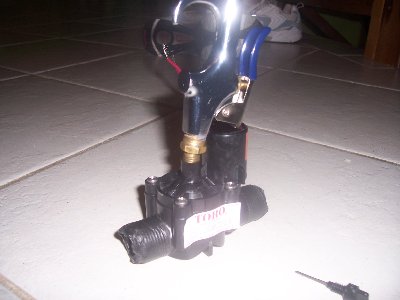

I FINALLY got my sprinkler valve thats cost me nearly $50 US wtf but anyway its a toro 3/4 male thread valve. I was wondering if i could just mount the blowgun where the flow control handle is. The toro flow control handle has a long needle attached to it, I just want to know if the flow control handle with the needle is important or can I remove this flow control handle with the needle and place the blow gun there ?? I just want to be sure of things soo i dont waste my cash on this mod
it all depends on if that "needle" which is probably your guide rod, goes through the piston, which it probably does, then i would find a spot on the side to drill into or find a way to keep the guide rod in the piston and all that deal cause the guide rod hole might just be big enough to leak air fast enough when you open the pilot to not open the piston but it's all up to you, oh yeah and you got raped on the valve i take it you don't live in the US

AHAHAHAH i have this valve
it is significantly more powerful than any other sprinklers i have used. good choice.............
anyway, yes, just slap the blowgun there. no other modifications are neccecary.............
on this model the guide rod can be removed entirely, it actually works better that way.

Lighter diaphragm - faster opening timeselitesniper wrote:how can it work better then other sprinklers valve?
More flow
Less pilot volume

Well you may want to drill your own hole as the flow control may only have a small hole, but if it's big enough I don't see why not.
There is a guide around here for modding valves with guide rods, just search for it.

well that needle may be the guide rod.
