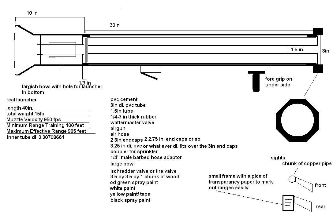

well the pic is pretty self explanatory, but what my plan is to make an small air cannon with a 1.5in barrel and a 3in chamber in a coaxial setup. it will be diaphram valve piloted by a modded sprinkler.all of the internals will be hidden under a larger di tube. i've been showing this to my dad, he doesn't think it will work. i want to hear for you guys wether or not it will work so pls tell me what you think.

the 3in endcap witch connects to the sprinkler valve right behind the diaphram.

sandman wrote:well i dont think that will work, because most people make their diaphragm so that it can be replaced but your design makes it permanent and that means that you have to get it right the first time.
Anyway what you are saying is that it wil work the first couple of times until something will happen and he could not do a thing due to it being permanent.
Anyway good lob i think it will work

im trying to think of a way to unscrew the back end entirely maby if i put a female connector on the front halve of the 25in mark and a male on the other.

somthing like this
it could also be used for breach loading

im sorry this is very noobish, but what is a union?
nm just looked it up on the wiki. good idia

im attempting to find online sources for pvc pipes because my 3 local hardware stores dont have any 3in pipe that can take pressure. any suggestions?
