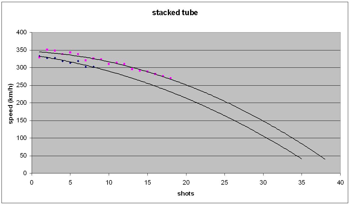

are shots consistant or do they with each shot?
Has thanked: 581 times
Techincally, as you shoot, the pressure goes down (meaning less power) but the resistance on the valve is also less, meaning it opens for longer (more power) so there should be a reasonable level of consistency.

jackssmirkingrevenge wrote:Techincally, as you shoot, the pressure goes down (meaning less power) but the resistance on the valve is also less, meaning it opens for longer (more power) so there should be a reasonable level of consistency.
Thats exactly correct. As thought I have done measurements of speed decrease over shots, and it does go down eventhough the dwell times go up. I guess bc the barrel has a certain length and a longer dwell time has no effect. I have this graph here of the stacked tube airgun (check attachment). I am not sure what bottle I used on this test though, 0.5L or 1.5L I also did this test before I had a compressor so I dont know the pressures I used.
