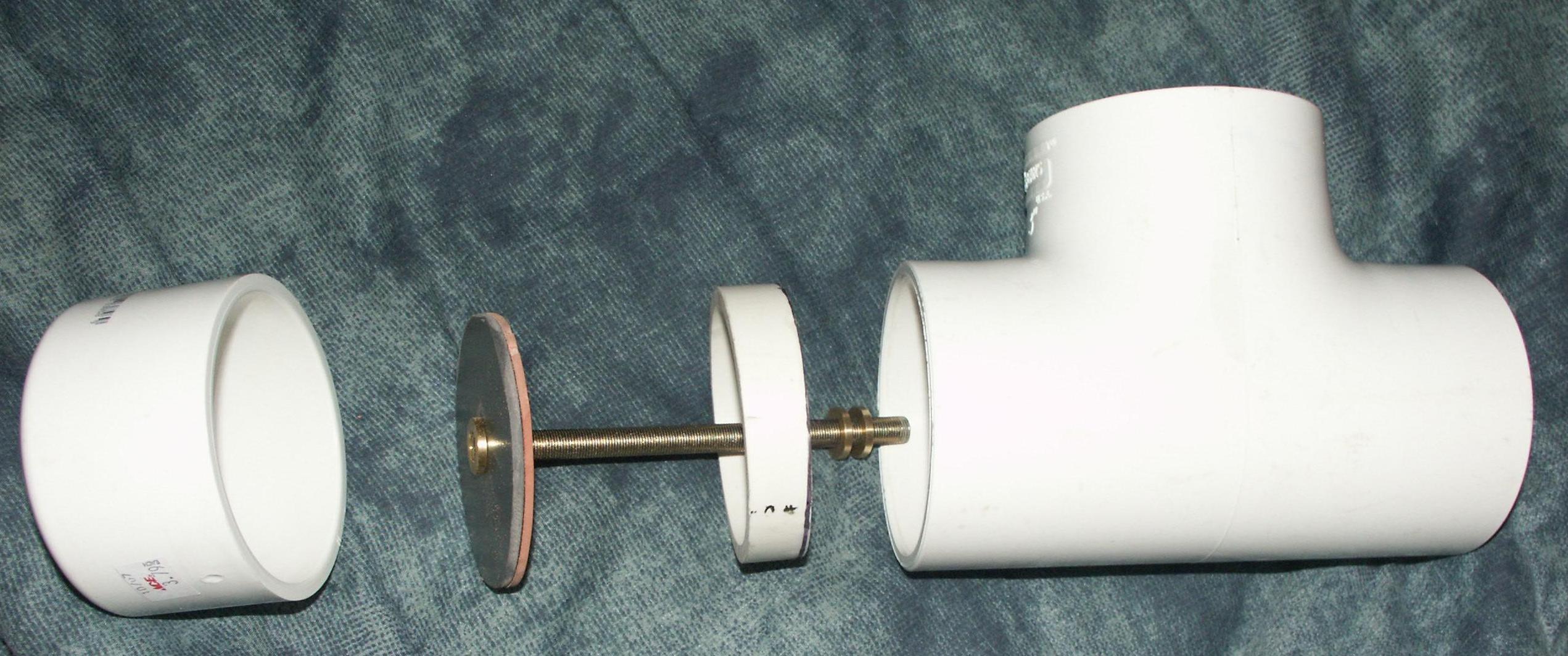

I'll have a pic soon and better explanation, but It's a new type of sealing piston Im working on, and where the piston slides back is the pilot volume (obviously), but I don't want to restrict the flow by not having it open enough.

Here's a pic to help get an idea of what Im doing.
Here's what it looks like together. The cap and tee will be held together by a 4" coupling.
Here's what I have so far. I haven't finished everything yet so so try to imagine it a bit. Hence why I did the paint drawing.

Octane, the disc that seals with the barrel needs to be the same diameter as your rear disc otherwise it won't be stable and won't work.

Thats something I figured when I started to make the seals. But I have that part figured I believe. I was just gonna make it the same size, but cut away some of the unnessecary sections to allow it to "flow" back easier.

Apologies for the sh!te paintshop, but you mean like in the attachment? that would work well.

Yea, essentially the same unless I cut it differently.
