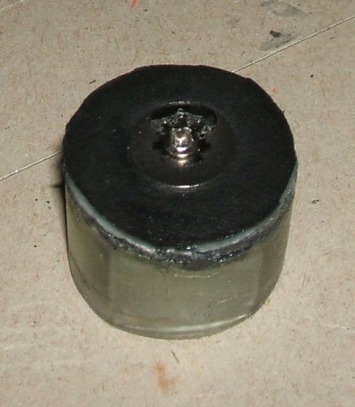

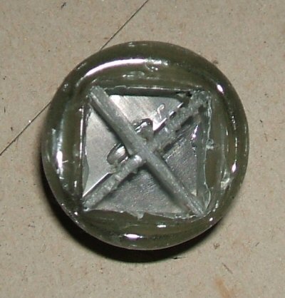

Here's the enormous piston
by adding an internal structure (basically a cruxiform syringe plunger wrapped in duct tape) to the casting it's not only light but also saves on epoxy, while still being strong enough for the job. This is how it looks like fresh popped from the mould, still needs some finishing.
