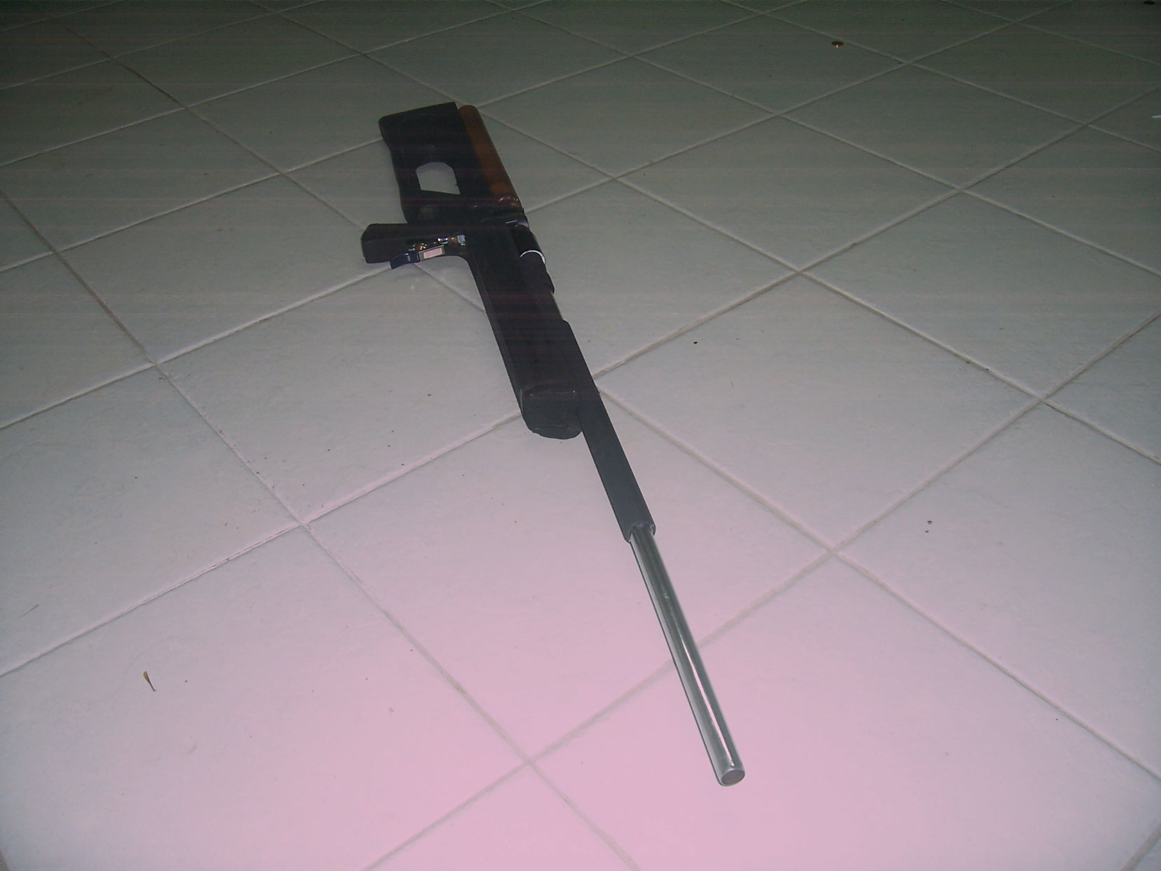

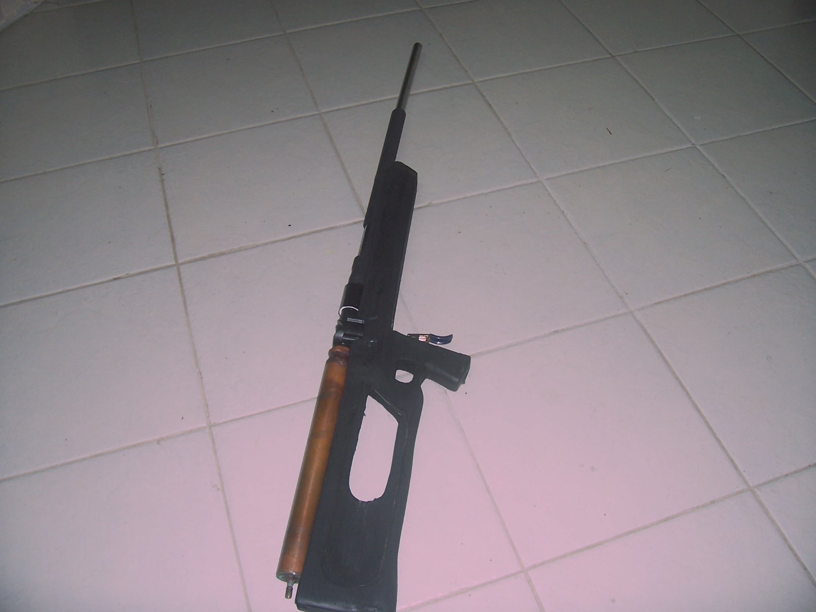

Ok guys its been a quite a while Ie been researching, designing and polishing n Now its finished. Think Im callin it the : PR1 Regal... i dunno yet still thinkng about it
Well its a
75 caliber
Single shot, sprinkler valve (3/4 ")
14 inch pull length,
bolt action ( not 100% finished yet...needs the bolt)
1.25x12" copper chamber pneumatic rifle
shooting at (according to software) 450fps with marbles as ammo
The body is made of wood( not sure what kind) & hot glue( lol yeh ... needed something to fil in the gaps with).The barrel is made of pvc and chrome rod ( to give it some shine :D ) Right now it shoots wax ... it can shoot marbles but the barrel isnt a perfect fit. None the less pretty good performace so far....Anyway enough chat here are the pics tell me what you think

Thats pretty nice I really like the stock and handle on it I wish I had the time, reasoreces, and patience to make something like that.
And is that acually your first i find that hard to belive.

Yeh its a first but it took verrry long to complete alot of research n....quite a bit of trial n error but I wanted it to be like a functional a show piece more so than quick project.

ya that looks way too good to be a first. unless you spent months and months in the research and design stage i don't know how you did it and made it look so good. and if it is a first then :shock:
nice gun i really like it. :D

And carl what pressure do you run it at.

umm I shoot it at 110-120 psi usually n Id say it took me the fall semester (workin on weekends) and the christmas vaction to complete. Lol i didnt expect it to take so long

cool. It reminds me of a P90 if the barrel was shorter.

nice work for your first pneumatic, is that breech loading i see?

Looks like an Aug. Nicely done.
