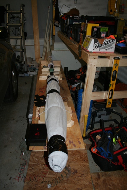

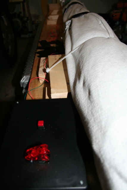

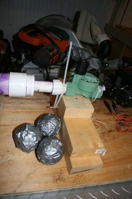

This is my second launcher, my first was a simple over/under with a ball valve. This one has 4'x4" chamber with a schrader in the cap. I am shooting duct taped tennis balls with it for the first time this Saturday. Later I'll probably mod the 1" valve so that it dumps air faster. The sweatpants are covering up jeans that are wrapped around the chamber just to make me feel safer. The leads from the solenoid are 35' and go into a project box with a safety and momentary switch.
-Thomas

But that 1in sprinkler is really constricting flow even if you modded it I would reccomend a 2in sprinkler or if you dont want to spend 90bucks on one a triggered burst disk setup(check wiki). A piston valve would be ideal but I am doubting that you are experienced enough to make one.
and why is the gun wrapped in a bunch of stuff it has been proven it wont help in the event of an explosion it just makes it worse.
and the coupling in the first pic is DWV the bushing doesnt extend all the way into it.Replace that and if there are any bell reducers on it replace those as well.
Other than all that nice gun do you mind if i ask what you pressureize it to.

You said that you wanted to mod the valve, but you also said that you have 35' of lead wire coming from the current setup. Does this mean you plan on making a pilot for the valve 35' long as well? I hope not.
Here is a way you can mod the valve and still keep the 35' of wire:
1) purchase another sprinkler valve
2) mod the current setup and adapt a 1" thread
3) place the second sprinkler valve onto the 1" thread
4) hook the leads to the new solenoid
That should provide you with adequate opening time, as well as the safety you so desire.

1)Thanks for spotting that DWV and letting me know
2)I have so far pressure tested it to 60 PSI
3)I didn't know that stuff wouldn't help if it blew up, another site had suggested it, I'll take it off
4)Yes after reading that PVC didn't show up on X-Rays, I am a little nervous it might blow up
5)Thanks for the tip on modding that valve, I think I might try a burst disk setup

What was this other site that suggested you cover it with stuff?
Check every joint that is on there and make sure it says nsf-pw if it says nsf-dwv you will have to remove it.

And with the burst disk thing I reccomend you go with a 2in union but you go through a lot of foil with those I guess a 1.5in union wouldnt hurt performance *that* much.
And are you planning a triggered burst disk setup or just pressurizing it until it blows

Glad to see a new member concerned with safety! Nice cannon, but you would see a MASSIVE performance increase if you used a 2" sprinkler valve or just a piston valve. However, it seems to get the job done the way it is!

Nice gun..funny story I wrapped my first combustion with old jeans and duct tape for fear of explosion...
Once you get those dwv joints replaced there should be no fear of explosion within reasonable pressures.
