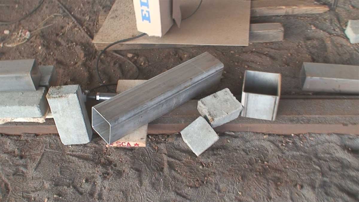

anybody else noticing the completely massive recoil? It appears to be launching bricks and those square metal bars backwards...

Dude... whats happening in that picture? did the recoil split that brick...?
