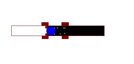

I was thinking about somthing like this there is sheet metal sandwiched between two unions and a 3/8 inch ball barring as the ball

I haven't a clue how to do an illustration.

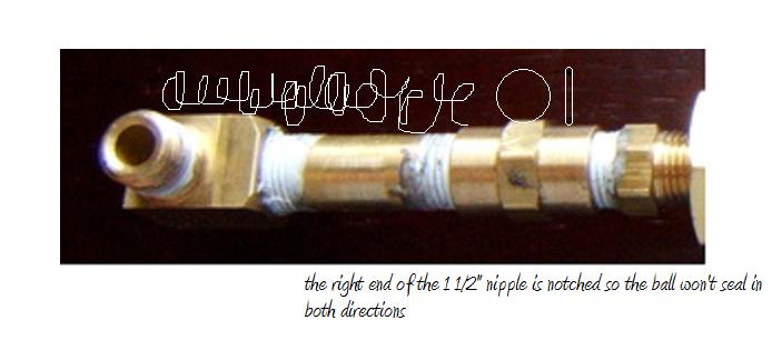

here is a check valve I put together from parts I got at Ace Hardware.
It has some perty crappy drawing on it,but I was in a hurry and I'm trying to get used to a laptop. This is all 1/8" pipe fittings in brass. In the mcmastercarr catalog fittings like these are rated at 1000PSI. The ball is a ball bearing, I don't know what size it is but it fits nicely inside that female to female coupling. the spring slides inside the 1 1/2" long 1/8" pipe nipple like it was made for it. The elbow is just a way to compress the spring slightly. the oring presses against the inside of the coupling and the face if the hex pipe nipple.
I have tested the setup to 300PSI so far, and it has worked perfectly. But, honestly if your more patient than me and willing to order something online Mcmastercarr has check valves that probably cost like a dollar more and are purpose made. I just wanted the check valve right away and honestly just like to build stuff.
Also if your going to build a high pressure pump, use a floating oring design. they are simple and work well. The only other thing I will say is don't underestimate the importance of keeping dead air space to a minimum.
