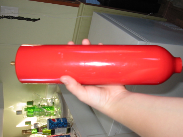

I guess so it would just be inefficient doesn't it cost how ever much money to fill them back up? I think you would be better off with a fire exstinguisher that has a shrader valve in the bottom.

I'm saying he could use the fire exsingusher if he had a device to get the pressure up high.

Remember that dry chemical fire extinguishers are only designed to operate at ~200 psi. CO<sub>2</sub> fire extinguishers, while much more difficult to find, are rated for about 1000 psi.
As far as getting the pressure up high, a 1000+ psi homemade pump is quite possible, with a good design and the right materials.
