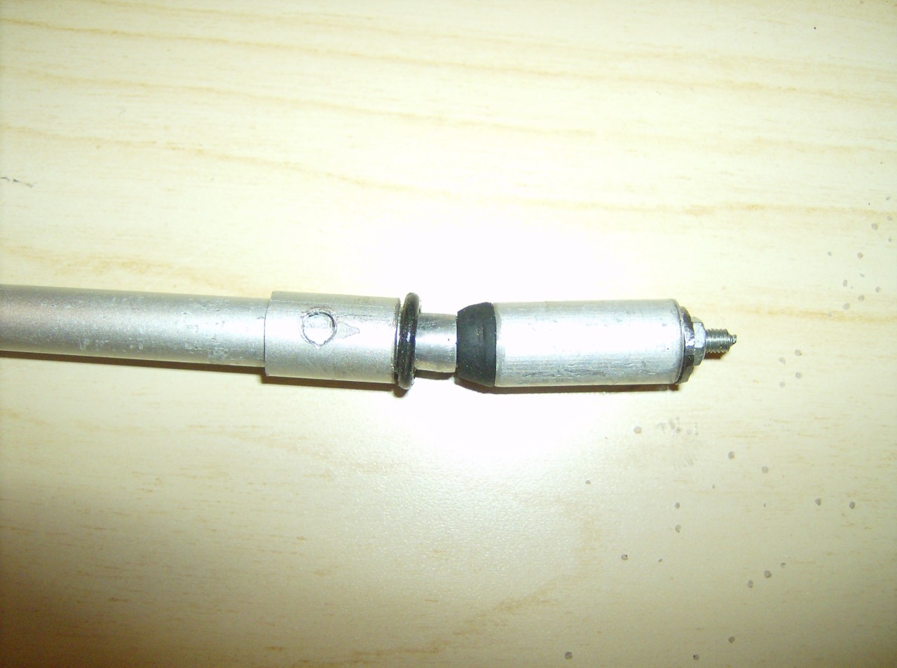

I finally was able to make this piston type of bbgun work. Its really basic, but does tend to leak out of the barrel sometimes. I was astonished by the power it had, its awesome. I think it has potential, but it doesnt seem to be as efficient as hammer type of airguns. But yeah I guess jack proved that it was a good principle. I tried using a electric solenoid to open the piston but it only worked using a blowgun which kinda disapointed me. I thought I could make it semiauto by using the electro solenoid. Do any of you have a advice to improve this? I will post some pics, prob this weekend.

You don't think letting all of the air out of the chamber for one high powered shot is efficient?
I'm looking forward to seeing the pics of this new creation.

Piston looks really heavy, what is it made from, Aluminium?
Aluminium piping yeah, it is prop 4-8grams. I used the same materials as on my older airguns.MaxuS the 2nd wrote:Piston looks really heavy, what is it made from, Aluminium?
Here are the pics. It isnt a really fancy creation, but I am happy with this piston as I have no experience with ehm. Well efficiency in my mind is multiple shots on an air tank. But ill c what I can do, bc jack really impressed me with his vids:)bluerussetboy wrote:You don't think letting all of the air out of the chamber for one high powered shot is efficient?

Its nice but you got alot of pilot room, but in time you will be making great guns, and JSR would be proud.

Is this a breech loader? It looks as though you can loosen the bolt and pull out the barrel. Interesting idea.
Your pilot volume is not too bad, but you may be getting a lot of leakage past your piston, which might be why your solenoid valve did not work.

Hey thnx, could you guys give more specific feedback as I have never worked with these pistons. Like I dont know what u mean by pilot room, I assume the back volume behind the piston. Does this affect the speed of opening or the amount of air that needs to be taken away in order to open the piston? I think using copper tubing there is allot of potential. This piston can be disassembled totally unlike most PVC pistons I have seen, i think this could be of great benefit. I dont know if ppl noticed that I recycled my old valve tubing to use it for this project":LikimysCrotchus5 wrote:Its nice but you got alot of pilot room, but in time you will be making great guns, and JSR would be proud.

I havent made any breech loader or anything yet. This is a pure prototype but with the materials I intend to use in the future. As I said this piston airgun can be totally disassembled. I used the oring from my previous projects to seal the barrel with the copper pipping. It works nice but the barrel needs to be sanded down a bit as it otherwise wont fit through the oring. I saw on your piston that it had an oring in the middle, i guess this seals it of better for leakage past it. I didnt make this as I was afraid that air wouldnt come to the back of the piston. Actually this whole setup didnt work until I put a round of tape around the piston so that it made a better seal. The problem is that the tape wears off, so yeah I gotta fix this. It would be beautiful to get it working with the solenoid, as it never really had any good use:) Hey thnx for the feedback.Gippeto wrote:Glad you got it working!![]()

Yes, the pilot volume is the air space behind the piston. The least amount of air you have to release the faster your piston will actuate. With tight fitting pistons and small pilot volumes you really can pilot them with prestas and shrader valves. Even your solenoid valve might pilot it if the pilot volume was small enough.
Nice looking first piston BTW.

Thnx for the explanation and the respect:)bluerussetboy wrote:Yes, the pilot volume is the air space behind the piston. The least amount of air you have to release the faster your piston will actuate. With tight fitting pistons and small pilot volumes you really can pilot them with prestas and shrader valves. Even your solenoid valve might pilot it if the pilot volume was small enough.
