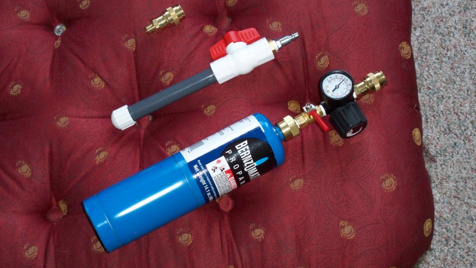

This below is not a complicated metering system. I'm using these for some noise making cannons. Just attach the quick connect to the chamber in a double walled area. Calculate the size and PSI of your meter tube and you are done. This one works in a 3660 cc chamber when filled at around 63 PSI propane.rcman50166 wrote:That doesn't conform with the assumption that the builders are age restricted kids.Carlman wrote:Q: What is the best type of cheap fuel

Edit: This will also keep the weight of your cannon down by not including the propane tank and metering system as a built-in part of the gun.
