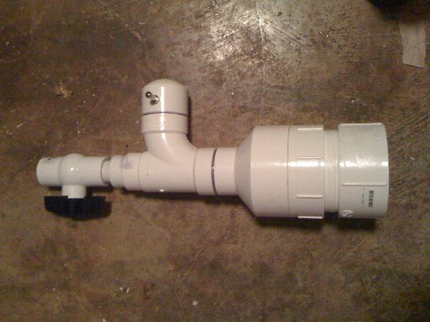

Ok, i got all the parts together to build the full scale gun that i was working on before, sorta gave up on the little one lol, might finish it later.

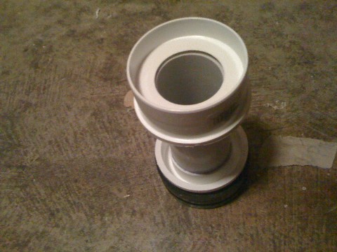

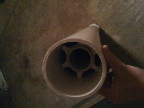

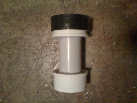

Just wanted to know if anyone sees anything obviously wrong before i glue the last few parts together. I've got a male and female threaded connection with teflon tape where the piston is, so i can open it up to fix it if i have to, 4"outter chamber, 2" inner barrel, using uncut pipe end for the sealing face of the barrel, nice thick rubber pipe cap on the piston.... looks pretty solid to me, very heavy though.
Will be in the cannons section shortly if no one sees anything wrong. Questions in the picture comments

Looking good, exept the pilot volume reminds me of my failed Coax. maybe it should be less.
and wow... is a barrel inside the chamber what defines a coaxial? ive been thinking they just have two brached fill chambers, thats what it looked like to me in clide's diagram at least. like the one on the front page that won the contest
take out the y and endcap, put the scrader into the pipe.

Holy CRAP!, That is massive pilot volume, you can just get a male adapter and a reducing bushing. And yes block ff the back of your piston.
haha, pretty obvious lol =P
i designed it like that originally cause i was using these really long tire replacement schrader valve from the local auto zone, and i couldn't slide em up into a hole in a pipe cause they were too long. spent the weekend stateside though and found some nice threaded ones at the lowes there lol. gunna have to buy more parts
i think ill put the change on hold though till i know if it will work or not

nope, it would increase more pilot volume and you should have a washer below your sealing face, make sure the pipe inside is nice square and smooth so it can seal.

you have a s**t loada DWV on the rear end of that, the Y, the cleanout cap, reducer and god knows the pipe may be too!
you need to fill the piston to reduce pilot volume, but thats not going to make a dent in the all ready massive one allready

Yep, you have a coax alright. You're only going to need 1/2" of piston "throw" to get the maximum airflow into the barrel so adjust the piston length to where it falls in that range. Also, make sure the piston fits the 4" cylinder extremely close but without a full seal and without binding...this is crucial, otherwise air will just slip out around the piston and out the pilot before it does the work you really want it to, which is unseal the barrel. You should also try to seal the pilot hole with the back side of the piston upon blowback. Your ball valve pilot will be cumbersome and slow so you'll lose some performance there. A modded 1" sprinkler valve would improve performance a great deal.JET47 wrote:and wow... is a barrel inside the chamber what defines a coaxial?
