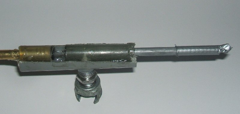

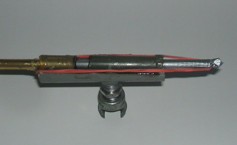

Well, I've made a very basic prototype of sorts. I'm aware that it's as ghetto as they come but I've never been the neatest of fabricators, and when it comes to prototyping function over form is the definite rule :)
The power is certainly there, it will send a 0.22 airgun pellet through both sides of a soup tin at 100 psi. It does leak a little in the "closed" position, but at acceptable levels as far as I'm concerned. As to this being "blowback" on its own accord, perish the thought - I fired about 10 test shots and not once did the bolt show any inclination to move back.
This means that some form of external power is in order, so it's either an electric motor driving an eccentric cam, or a pneumatic piston to keep the system "air only", which is preferable in terms of convenience but would divert precious air away from its function of propelling the projectiles down the barrel - so it'll probably be electric.
Watch this space :)
The prototype in all its ghettoness.  The rubber band is just a temporary measure, the real deal should have a tension spring (or two ;D) - bolt is shown in the "open" position (with breech access to the magazine closed) - the duct tape is there as an improvised "bolt stop" to prevent the bolt from going too far into the barrel.
rubberband removed, bolt in the "closed" position (with breech access to the magazine open)
bolt removed
bolt removed
jackssmirkingrevenge wrote: I fired about 10 test shots and not once did the bolt show any inclination to move back.
Ohhh that's suprising.... maybe the rubber band is to strong or the pressure is too low...?
anyway, it looks nice :)
Well, I only have 110 psi max on tap and the rubberband is just strong enough to overcome the friction. In order to be successful as a blowback I'd have to sand down the bolt to a smaller diameter so it's a looser fit, to cut down on friction, but that way it would leak too much to be viable - so it looks like the electric route is the best idea.
