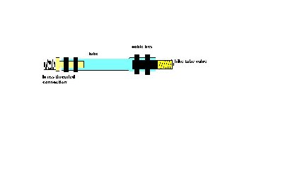

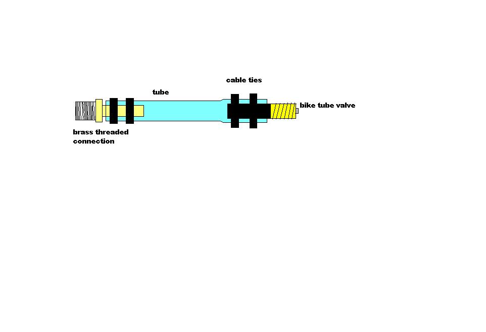

"well what i do is get a threaded brass pipe connection,some tube and a bike tube valve oh and some cable ties and then link them all up ,install the piece onto your gun.eg."
could tou please explain in more detail?
is what your saying: take the schrader and put it into a crass tube and screw the tube in?
thanks if you can explain
any more info is apreciated
