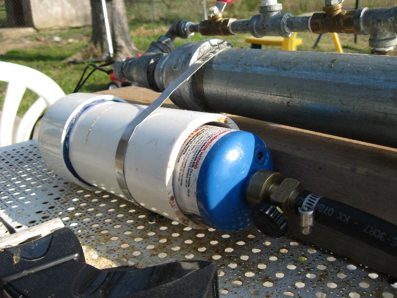

This is my first hybrid launcher, thanks to this site. It's nothing fancy, but it is my first and I am proud of it.
I've not taken past 6x, due mainly because I only have a bike pump. I just got an air compressor, so we'll see where that leads.
It is made of 2" Sch40 galvanized pipe. The meter is comprised of 1/4" nipples and 1/4" ball valves. The frame is made of two 2x4s nailed together. This keeps it off the ground. I plan on building a tripod for it one day.

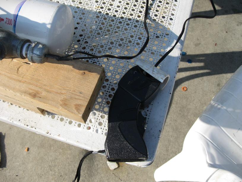

Here is a link to the spark system: Hubbrid Spark Plug

The union is a 1". I already had a 1" x 30" barrel and I built the launcher around it (although some would argue with that). It has a ratio of about .8 to 1.

I like the spark plug and i think its what im going to use on my hybrid (eventually
) but also what is the insulation on the wires? Is that electrical tape? And if not, then would electrical tape be a good insulator?

The insulation is heat shrink tubing. I drilled two holes in the cap just slightly bigger than the coat hangers. I measured them, sharpened on end and looped the other, then put the tubing over the hangers and shrank it. I double layered it to make sure it would not ground out against the chamber. To secure them, I filled the pipe cap with JB Weld, then tightened down the nipple.
I guess electrical tape could work.

The biggest reason I put the pop off on the meter was because it was the only "plug" I had to put in the tee, which I already had. Make sense?
In other words, this is basically a spare parts gun and it costs me about $10 to build and get working. Almost every piece on here was used on another launcher.
