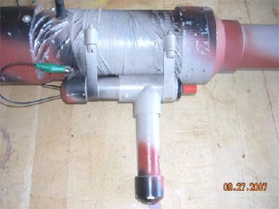

Go with the BBQ piezo.
Yes, the electrodes will gum up with hairspray and the like, but a flint sparker will gum up just as bad. The common way to prevent gumming up a flint sparker is to mount it in the cap. That is a very bad idea. It puts you hand in line with the part of the gun that is most likely to fail. In addition, setting a loaded gun down on it's breach can fire the gun.
If gumming is a problem then don't use a crappy fuel like hairspray. Get a $0.50 butane lighter from the local bodega and use that.
BBQ Piezos can be easily mounted in a pistol grip handle. No "rats nest" of wires and it looks much more professional than the gunner standing their trying to balance a 5 foot long gun with one hand while he spins the flint sparker with the other.
I've been using the same generic BBQ piezo for about 5 years. To make it easy to swap between my guns I put aligator clips on the ends of the Piezo's wires (you can see a green aligator clip in the photo). I don't think I've ever had a sparker induced miss-fire.
