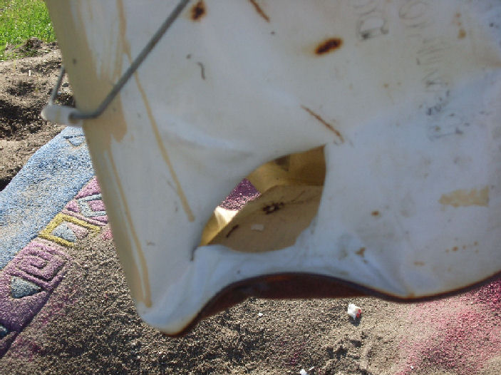

Thick 40litre paint can cut through like butter, the ball continued on through a surfboard afterwards
