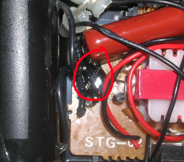

OK I have a little problem. I installed a stun gun ignition in my combustion spud, and it was working well except I noticed that my wires weren't quite insulated enough because occasionally it would arc between wires, so I took everything apart and used some +33 electrical tape on the wires which solved the problem, HOWEVER I noticed that there was some arcing INSIDE the stun gun case. I circled what was arcing... except it may be hard to see, I put liquid electrical tape on the problem area. It looks like two metal bands in an "X" form, and it arcs between them.
Has anybody else had this problem?
Maybe I should shorten the distance in the arc gaps?

I had a stun gun like that also, a 100k volt one. There were two metal strips that overlayed each other, and arced. Don't mess with them. I tried soldering them together, and then insulating them from each other and it didn't help anything. It just kept it from working. So, in short, just leave it as it is. It's not a defect, that's just how it works I guess.

Pyro is correct. The "X" is a spark gap and is required for the stun gun to work. Basically, it is the "high voltage switch" between the first and second stages of the amplifier.

Ok another question for you then... Would too large of spark gaps damage the stun gun? Right now I have three spark gaps, each about 1/2" gap... Do you think that is too much of a gap? I've seen decreasingly dimmer sparks between the gaps which initially lead me to thinking the sparking inside was a problem.

Did you leave the "default gap" of the stun gun alone?
Most stun guns have two sets of electrodes coming out the business end; one set that points inwards towards each other (the default gap) and another set that points outward (towards the poor bastard about to get zapped, these are the main electrodes). If the distance between the main electrodes is too far, the arc falls back to the default gap (because electricity follows the path of least resistance). This acts as a safety feature to prevent damage to the circuitry, also.
If you removed the default gap, you could make one quite simply. Let me know if you need further help with that.

What's the volatage? If its a 100kv, your gap should not exceed about 1.5" For a 200kv, about 2"

I'm using a 200K gun. Would going up to a 400K stun gun be overkill? I have one that someone gave to me, but I put the 200K on.
I took out the default spark gap, but I'm not going to make one. I fried the circuts when I was messing around trying to take back off the liquid electrical tape... oops... But i have the 400K to fall back on as long as its not too much.

The only thing I would add is to keep the total spark gap small. Even though a "200KV" stun gun should be able to spark 2 to 4 inches I would keep the total spark gap at less than 1/2 inch. You really risk frying the stun gun if you pull the trigger and you don't create a spark somewhere (that is what the safety gap is for, as Pete said). I would suggest;
1. Keeping the total gap length in the gun at no more than perhaps half the safety gap.
2. Leaving the safety gap functional.
These $10 stun gun aren't exactly quality instruments. They appear to have about the same reliability problems as piezo BBQ sparkers. It is not unusual for one to crap out after 10 shots, or for one to last thousands of shots. How long a particular stun gun lasts seems to be a real crap-shot.
