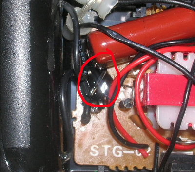

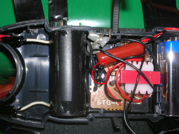

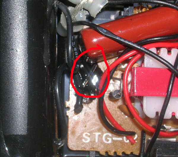

OK I have a little problem. I installed a stun gun ignition in my combustion spud, and it was working well except I noticed that my wires weren't quite insulated enough because occasionally it would arc between wires, so I took everything apart and used some +33 electrical tape on the wires which solved the problem, HOWEVER I noticed that there was some arcing INSIDE the stun gun case. I circled what was arcing... except it may be hard to see, I put liquid electrical tape on the problem area. It looks like two metal bands in an "X" form, and it arcs between them.
Has anybody else had this problem?
Maybe I should shorten the distance in the arc gaps?

I had a stun gun like that also, a 100k volt one. There were two metal strips that overlayed each other, and arced. Don't mess with them. I tried soldering them together, and then insulating them from each other and it didn't help anything. It just kept it from working. So, in short, just leave it as it is. It's not a defect, that's just how it works I guess.

Pyro is correct. The "X" is a spark gap and is required for the stun gun to work. Basically, it is the "high voltage switch" between the first and second stages of the amplifier.
