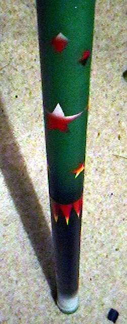

I would like to see a better shot of the paint on the barrel.

The wires are double insulated, once by their own, and again together inside another sleeve, the tape just keeps them flush to the cannon. If you want to see a better shot of the barrel this is the best i have at the moment, waiting for batteries for my good camera to come in the mail...
colors look bad in the photo, white faded into blue faded into green with red and yellow "circus" flames red and yellow stars, red and white stars, red and white diamonds, and black and white diamonds.
