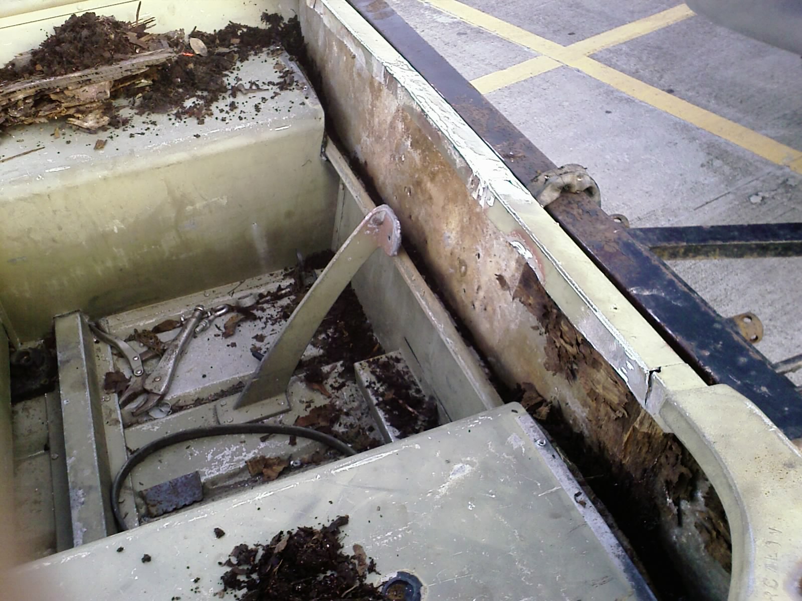

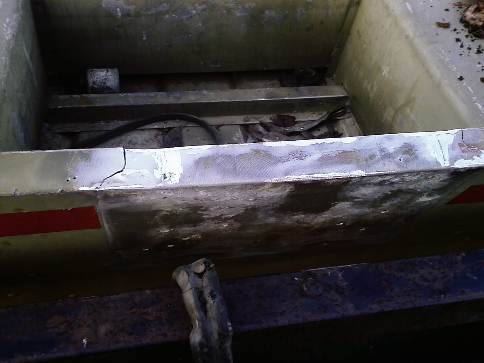

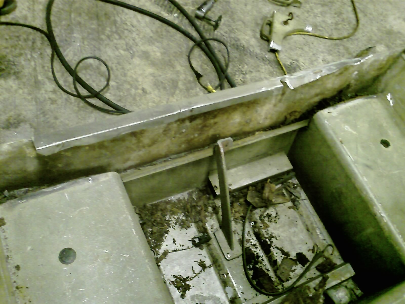

Anyhow, I inherited a 14' mud riveted flat from my grandaddy down in chackbay and it needs some work. He tried running a 45 hp Yamaha on it, and cracked the transom. From what I can tell, he and his buddies tried to fix it with some 1/8" sheet, but it was a pretty shoddy job of welding.
So I got a galvanized trailer in great shape, a half decent bateau, and a Johnson 25. I plan on putting new plywood in the transom, covering that with some 3/8" sheet, running a gusset from the plate to a plate/c channel on the floor, and capping off the top of the transom with some more channel aluminum. I plan on welding on the channel, plate, and gusset (probably square tube or more channel), but I'm not sure about welding these thicker pieces to the boat aluminum itself. All the added parts will either be 3/8" or 1/4" thick.

This is what I had originally toyed around with in my head. And by all means, it would work great, but since bossman gave me a bunch of aluminum plate and box tubing, I'll be making the whole thing out of aluminum. No wood! :D instead of plywood, 2 pieces of 1x 4" box tubing stacked vertically, some 3/8" plate as my buck, some more 3/8" plate on the back of the transom, some c channel to top it all off!
Overkill? nah. Not to mention the floor plate with some box gussets. If everyhting goes right, I should be looking at a flat that can handle a 40 - 45hp motor. Kinda scary actually... :D
