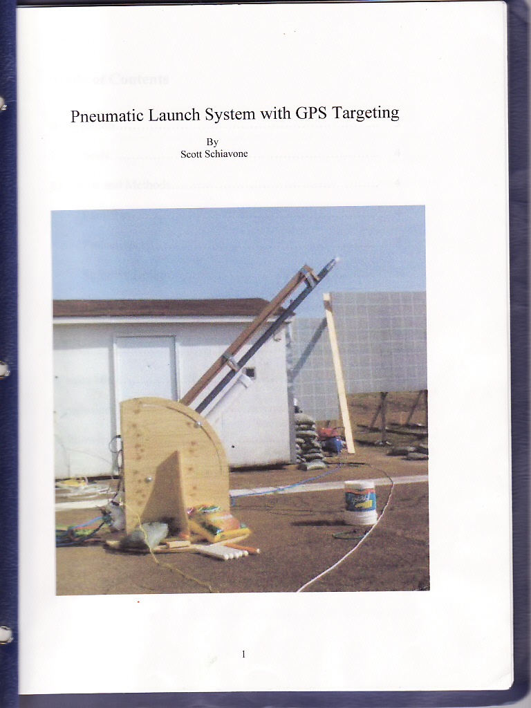

The Cannon Chamber is constructed out of 4" sc40 PVC and is 5' long. The barrel is I believe 1 1/2 in sc80 but it has a sleave insert into it that that is some sort of super thin vacuum pipe. The vacuum pipe fits perfectly around my projectiles, so I slid it in that sc80 and called it a barrel. lola The entire barrel is 9' Long. And you can see in the Picture the that it had to be supported to make it more stable.

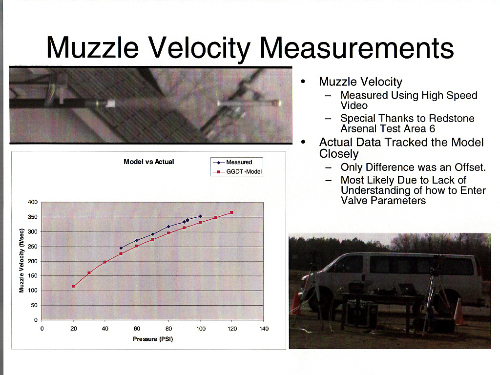

Some Stuff on the various Projectiles I used.

SpudFarm
Posts: 2571
aha! now we can see the scale:P
HUGE
"Made in France"
- A spud gun insurance.

Now that Sir...Is definitely more like it.
From the other picture, I got the impression that it stood about 2ft high.
Great work mate!

Whoa it is huge yes that othe picture definitelry made it look about two foot tall. Cannont wait for a vid on this. How much dough did you put into making this, electronics and all.

MaxuS the 2nd wrote:From the other picture, I got the impression that it stood about 2ft high.
I think it was not the same launcher on the other picture you're talking about (it seemed like white PVC)

OMMFG! lol. From the other picture, I thought I could step on it and break it, but now that you actually show its towering scale, It looks massive.
How did you take that other picture anyway? It sure fooled everybody..

I took that other picture from the top of my 10' Porch. lol

I notice you used GGDT.
Mind if I get a data dump from you so I can put it up in the library? 'Tis rare for me to see somebody with significant data that I can use.

Yes I did use it! I found it to be extremely helpful during the design stages of my project.
and yes I would be happy to help out. What sort of Data you looking for?
