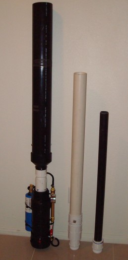

My multi-barreled gun has a propane setup now. I can tell the difference between using Gumout Carb Cleaner and using the propane. Very consistent and about 20% more powerful. Hey, I still have to give Gumout it's props...it's still pretty good.

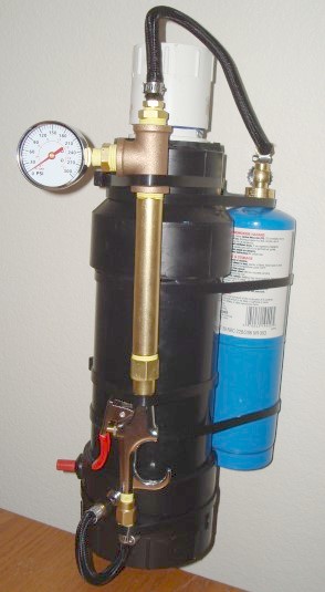

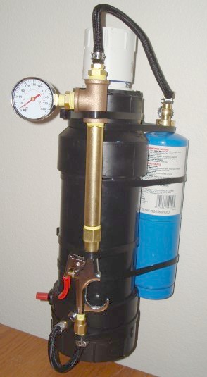

I wrenched off a propane torch top and used hose from a broken bicycle pump. The hose after the blowgun screws into a tire valve.
Softball w/Gumout distance (measured with a GPS) = 686 ft
Softball w/propane distance (measured with a GPS) = 885 ft!!!
Dialing it in today for a couple of hours was FUN! The softball attachment requires a little more propane than the other barrels. The rigging is zip ties for now until I build a nicer housing for it later.

- all the barrels
- softball_cannon.jpg (31.42 KiB) Viewed 3828 times

850 feet is some wicked distance with a softball, thats a 4 inch chamber right? and about what psi do u use. great job!

4" chamber, 4" softball barrel (seated 4" above the breech to create a larger combustion chamber.Spuddin wrote:850 feet is some wicked distance with a softball, thats a 4 inch chamber right? and about what psi do u use. great job!
With the propane setup I have, I pressurize to 30 psi and when using the softball barrel I use 36 psi.

Very nice! You've been making a lot of headway the last few days. Once you go to propane you wont want to do anything else. Looks like you've the fuel/air mix right too. MAPP offers a little more energy, however, without a burst disk setup, it's unlikely you'll see a significant performance difference from propane.
On your meter, you decided not to use a valve to close off the propane tank from the meter...?? How are you injecting the right amount? Resticter and quick shot method?
Keep the propane bottle upright...tends to leak liquid propane if upside down.

There are 2 valves. There is a valve on the propane can adapter (hidden from view in my pic) and the blowgun is my other valve. I could have used a ball valve in place of the blowgun but I think this way looks better.
